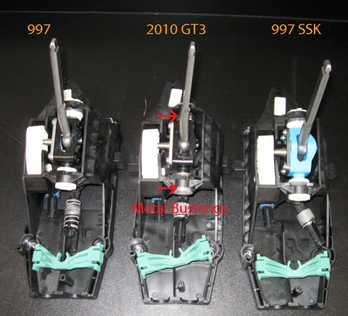

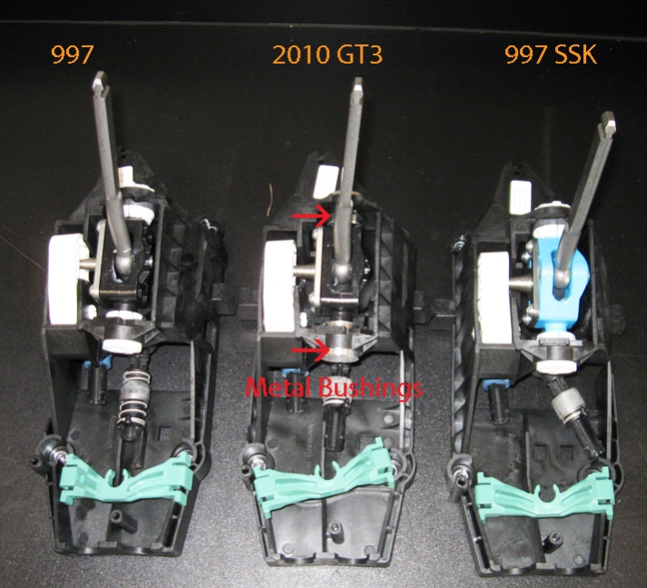

Comparaison des 3 leviers de 997, qui peuvent etre montés sur 996 facilement, ils sont livrés avec un alignement préreglé d'apres ce que j'ai compris ce qui n'est pas le cas d'un kit aftermarket:
- 997 stock: 15% de reduction par rapport au levier 996 stock
- 997 GT3: à priori idem, mais montage sur bagues métal
- 997 SSK: -35% par rapport a 996 stock, -20% par rapport à 997 stock/GT3
996 standard shift console
996 424 010 05
152
997 *withOUT* SSK
997 424 010 00
173
997 console "GT3"
997 424 010 91
313
997 *with* SSK installed
997 424 983 00
427

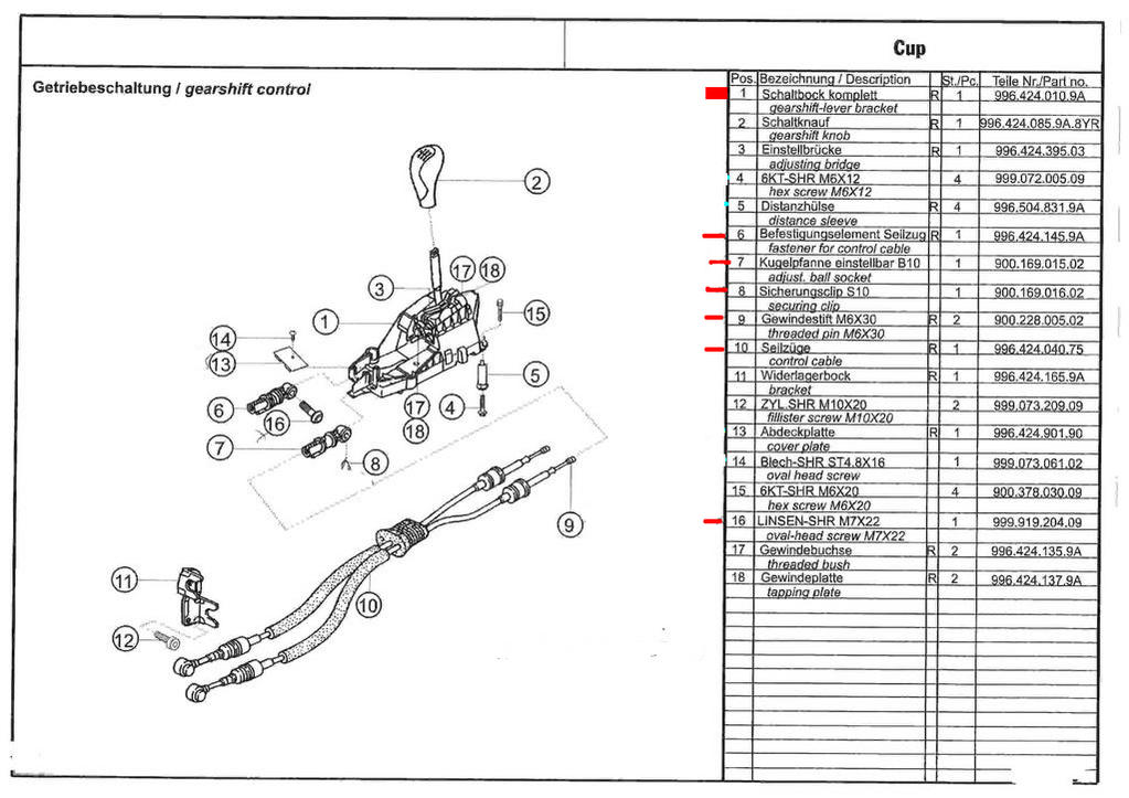

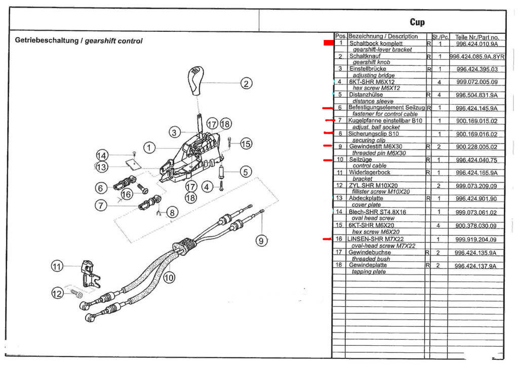

"In order to correctly and safely install the cup cables with the oem 996 shifters or 997 shifters or 996 cup shifter you need the parts marked with red on the attached diagram:
Some of them are ordinary items and can be fetched outside Porsche. (since their cost is very low just order them together to save time and help your tech do the job)
Note that 2 small 10mm nuts required to secure one stud are NOT in the parts list and must be bought separately.
If you are going to use the cup cables, don’t bother reusing the end tips of the oem shifter by patenting an attachment method, because they are plastic and not up to the job of handling the stronger thicker cup cables, also the point is to remove rubber and plastic for better feel.
1. Shifter 996 424 010 9A
2. Fastener for control cable left 996 424 145 9A *already comes with threaded pin and 2 nuts
3. A. fastener for control cable right / ball socket 900 169 015 02
B. securing clip 900 169 016 02
C. x1 threaded pin 900 228 005 02
D. two M6 thin nuts
4. Cables 996.424.040.75
5. Oval screw for securing item 2 to shifter 999 919 204 09 * oem is a plastic POS that fails see link. Photo of the plastic rivet courtesy of Mikymu. see link
For the strippers, if some of you want to lift the shifter upwards you can buy the extensions and bolts, shown in same diagram, and you also need to buy the retainer and a bolt to secure the cables to shifter. items 15,5 and 13,14.
Note that if you choose to do so, the center console has to go : )
